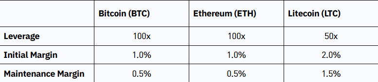

1. Monitor maintenance margin requirements and select a suitable leverage
For instance, the BTC perpetual future contracts necessitate a 0.5% maintenance margin of the notional value (the lowest risk limit setting), while the LTC perpetual futures contracts require 1.5% (the lowest risk limit setting). Be aware that different futures contracts may have varying maintenance margin requirements.
Choosing an appropriate leverage is also helpful in avoiding liquidation, because the leverage impacts how likely you are to be liquidated. The higher the leverage, the lower the amount of funds available to use as margin.
